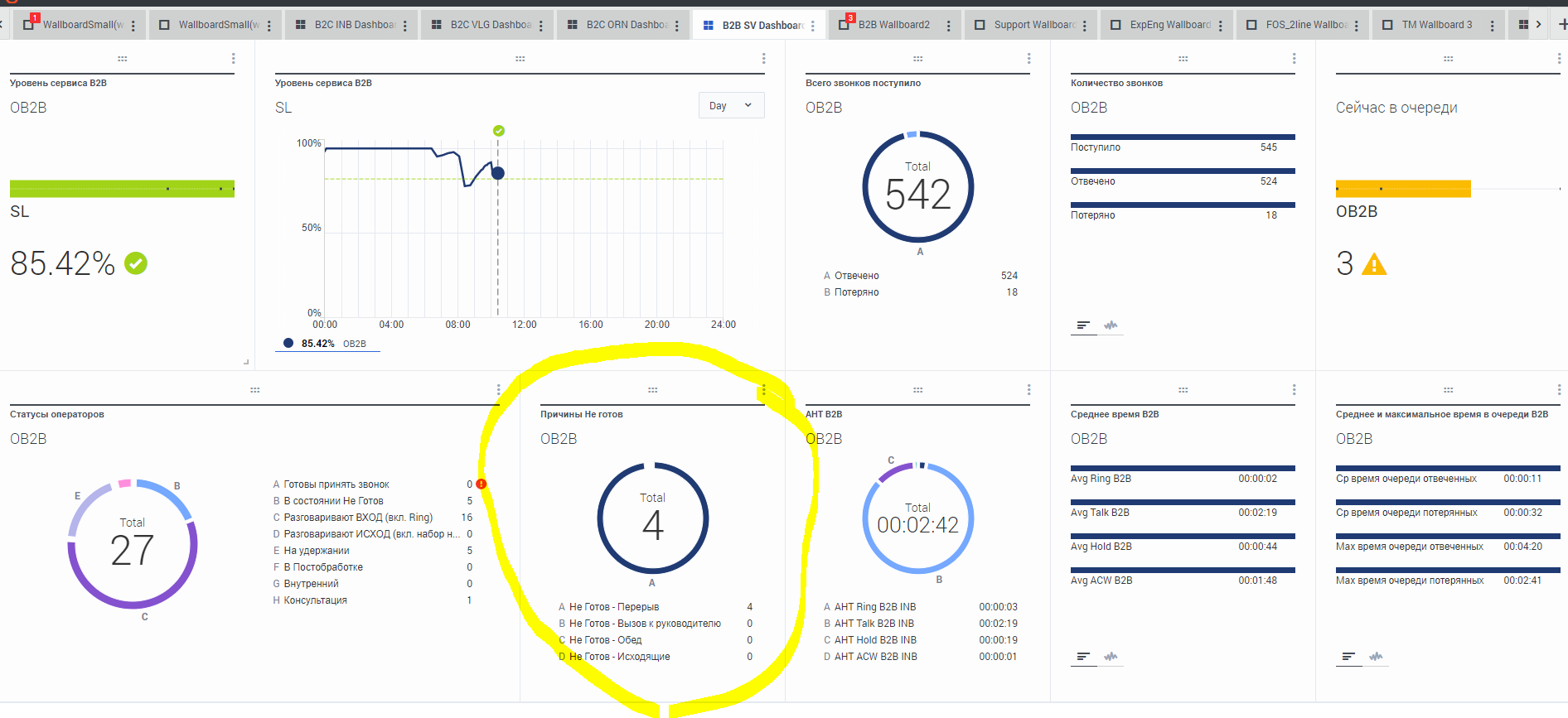

Hi!
Can’t you use donut widget for Agent Group? Hence you will have number of agents for each ReasonCode but listed by Reason Codes (not agent names).
Here how it looks like at our site.

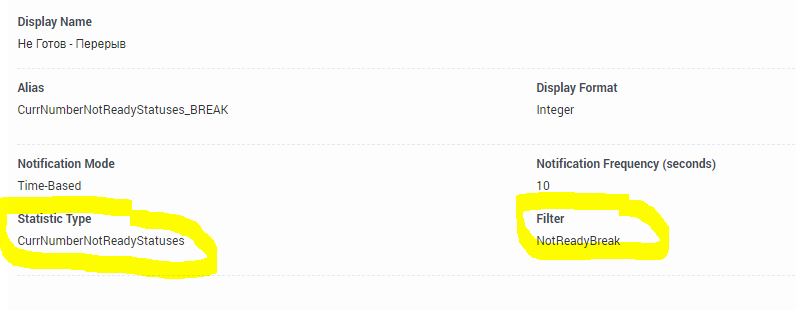

We use this one with respective filters:
https://i.ibb.co/mG3N97t/pulse3.png
Filter = ReasonCode
